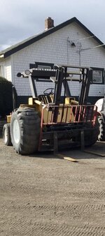

This would work for you Ed. My 5000# rough terrain with wide view mast.
Ordered it with a short 10 foot mast as I didn’t need or want the extra weight for loading trucks and trailers in the field.
Ford industrial running gear same as a backhoe as back then all our tractors were Ford or New Holland.

That would definitely come in handy lis. I miss my big old Hough loader for it's lifting capacity and ability to get around on nearly any terrain. I'm going to try to get by with a single lift though. If I do justify another machine it will probably be a skid steer...for yard work and such. Ed.
