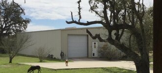

tez929rr
Dec 26, 2005
3,801
Welfare, TX
Two steel buildings. 40 by 60 (in 2004) $43K. 30 by 80 built in 2015 (lower height) for $43K. Interior finished out for another roughly $10K. Septic system and utilities another $10K.
