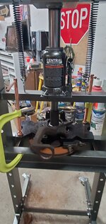

Well I had a Toyota spindle in the press last night that wouldn't budge! Changed my setup a couple times. I don't like not having a gage. I think I just about had the thing maxed out. Check this out I'm sure yall will love this. I will be boxing in the c channel or upgrading. It's a bit sketchy when you start getting up to the limit of the jack. If you ever had something fly out of the press it makes you think about what you are doing. I had a 10-12 ft shaft fly out on me when I worked in the machine shop. It came out at an angle and hit the chain link fence on one side of me absorbing most of the energy then rotated and hit the fence on the other side and fell at my feet and never touched me.😳

I'm adding a cage to my 50T. I've never had anything fly out but I've had stuff "move" and that was enough pucker for me.

I was at the point I was going to put a sheet of plywood in front of it! When it moved the whole press jumped. I had walked away from it to just let it sit for a second. I had my back turned to it and it scared the sh-t out of me.
