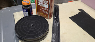

Anyway, back to the build. As it turned out, the filter fit neatly into the opening in the Shop-Vac lid:
I added some EVA foam as a simple gasket:

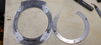

I used some thin cardboard to make a template of the top of the Shop-Vac lid, then cut one sheet to mate with the lid, and a second to mate with the Ametek Lamb motor:

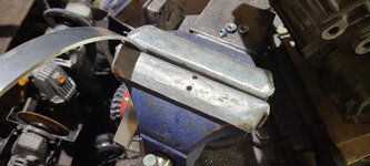

A strip was needed to attach these two parts. The necessary width was determined by screwing the aluminum base to the Shop-Vac lid, then setting the Ametek motor in place and measuring the needed height with digital calipers The strip was bent into a semi-circle using a bench vise. :
Then it was clumsily welded together. Turns out the argon gas hose was split, hence the awful time I was having getting a puddle going!

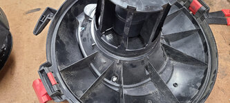

I actually used it this way for about a year, with the top of the Shop-Vac controls just pressed onto the top of the Ametek motor. The circular relief on the underside of the Shop-Vac top happens to have a nice interference fit with the top of the Ametek motor. Worked great, but it couldn't be picked up by the handle. Eventually, I got around to encasing the top of the Ametek motor and providing a threaded connection:
