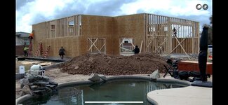

This is the second shop I've built. 16' ceilings.
I put 7, 4' x 20" up high. the are going to have blinds on them this time though.
I like the up high as it doesn't limit my wall space. We really don't have issues with flying insects so we dont have to take screens into account so mine don't open.
