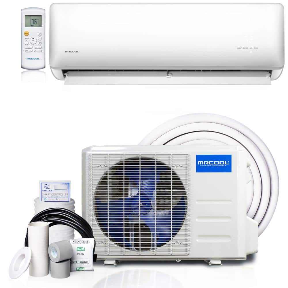

Thanks. I’ll keep looking. I did not see in the Mr. Cool manual (non diy).
I am able to put one head unit very close to the compressor. The other can be 15‘ or so.
In a blinding flash of the obvious, I guess I could try to arrange it so I have a vertical drop and then a horizontal run to the compressor. Though I’d rather not.

Aren't the linesets evacuated and sealed?
How will you pull vacuum if you cut?

The mr cool diy are. Others, the main unit is pre charged. You install them pressure test and vacuum with a pump. Then release the refrigerant from the main unit.
My set up really needs custom lines.
