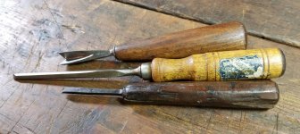

I don't do any woodworking and I don't collect turning chisels, per se, but I do pick them up from time to time in the wild if I see one that looks very old or interesting for some other reason.
These three (See Pic 1) are pretty good examples of that aesthetic.
The one in the middle with the decal is the "newest". Made between 1945 and 1949 in the British Occupied Zone in postwar Germany, marked "GERMANY BRIT. ZONE" (see Pic 2) on the shank. It's a Steelcraft. I have a small collection of Steelcraft "Zone" tools, including e-z-outs, a spiral push-drill, some other things, and now this chisel. Almost certainly low quality given the entire ouvre that Steelcraft operated in; it's the time and place it was made that scratches my itch.
The chisel at the top is a J.B. Addis & Sons. Due to how short it’s been sharpened, one can only make out "Addis & Son" and under that, "effield Eng.“ (see Pic 3). Not sure about the "39" (see Pic 4). It's the marking on the other side of the shank/blade that is pretty cool. In doing some reading on a handy collector’s site, it looks like a number (probably a "10", indicating the gouge size) followed by "PRIZE MEDAL" (see Pic 5), which Addis used as a sort of branding convention after winning the London Great Exhibition in 1851 and several times thereafter. I think it dates from 1872 to 1876 after he moved to Sheffield from London.
The one that looks like the handle is literally just a few steps past being chopped out of a tree branch (see Pic 6) is my favorite. I can't fully make out the name on it, but it's possibly "W.GREAVES" (see Pic 7). Does that ring a bell with anyone? Or just an owners mark?
EDIT: Disregard the question. I just realized I had been seeing and researching the name Graves previously. Google and Google Book searches on "Greaves chisel" turn up plenty of information on a William Greaves & Sons Sheaf Works in Sheffield, England, makers of chisels, cutlery, and coopers' tools. Almost certainly another 19th century tool.
