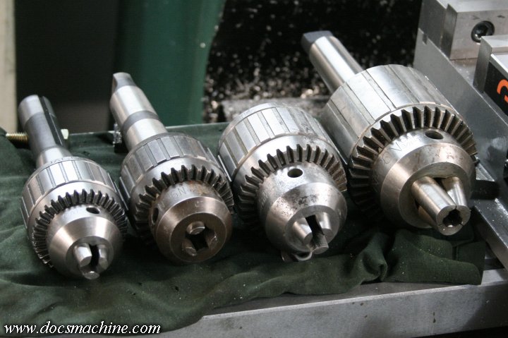

I also have a 2J collet chuck for both D1-3 and, D1-6 spindles along with collets, rounds by 64th's to 1 3/8[.]
-Noice! I'm a big fan of collets on the smaller lathes (5C, of course) and wanted the capability on the big Springer too. I'd been keeping my eyes open and by random luck, I recently picked up a low-miles Hardinge/Sjogren 3J, with 19 Hardinge round collets (roughly by eighths, with a few sixteenths in there) for just under $300.
One of these days I hope to get the damn lathe back together so I can actually use it. :D
drill chucks to a 1" supper chuck.
-A Supper Chuck is when grandma throws the Christmas turkey at you, isn't it? :D
I'm kidding, I'm kidding!
I'm a fan of Jacobs Super Chucks too. I have a couple keyless around here somewhere, but 90% of the time, I'm reaching for one of the pre-Chinese Jacobs.
Left to right, a 14N on an R8, a 16N on an MT4, an as-yet unassigned 18N and a 20N also on an MT4.

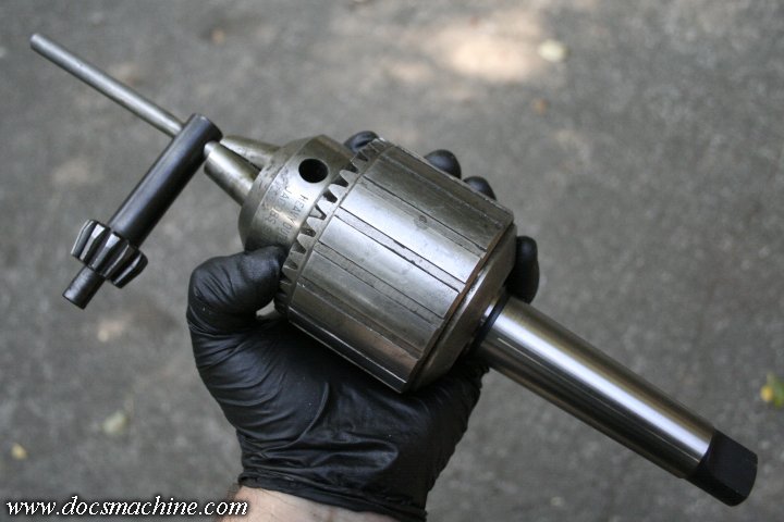

And in case anyone's interested in how big a Jacobs 20N chuck is...
Keeping in mind I have Desert Eagle sized hands. :D That has a max capacity of an inch.
