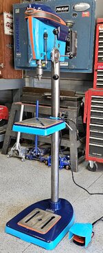

I just finished restoring a 1949 Canadian Buffalo 18" drill press so thought I would add a few pics to this thread.
The VFD arrived today and still have to sort the wiring out so will still be a week or more before I can get it up and running.
I used one of those with a custom made intermediate pulley in the drive train for years.
grannyknot
Feb 13, 2021
84
Toronto
To slowdown the spindle speed for metal? I was going to try and do that but the main column is in the way so an intermediate pulley would have to be of to one side.
