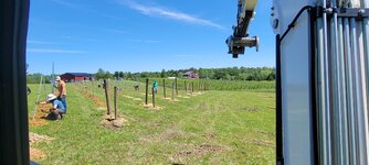

Going to be helping a friend expand his vineyard this weekend by pushing in over 1,000 metal trellis posts. I could use the bucket heel but decided to throw together an Xchange adapter that can later get turned into something else, or just stay as is in case I end up helping with any other fence projects in the region. Two evenings of tinkering after work. Didn't fully weld the cup on in case I do salvage this for a different attachment later down the road. Made of 5/8" A36, some 3/8" A50 HRPO, and a piece of 4x4x1/4" box. All done in the garage shop here. Ohh, the pin bushings were from some 1.75"x3/8" 1026 DOM. Millermatic 255 that was almost out of gas, so I was working sparingly to get this done as I can't get to the LWS till next week.

Excavator? Nice idea!
Way over kill, I love it.

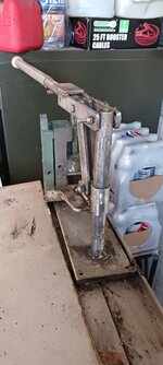

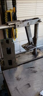

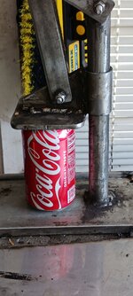

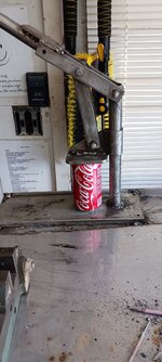

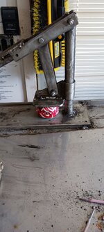

fabricated this stainless steel soda can crusher awhile back, but never took any pictures. It took 4 trips to the local scrap metal yard to get the materials. The plans came off the internet.
