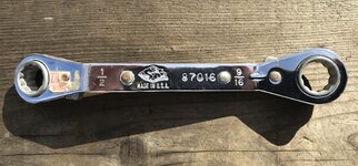

This is the only Lang-designed ratcheting box wrench I own, a "Kastar" model probably left over as a salesman's sample from when I was an independent sales agent representing Kastar about 30 years ago:
Kastar ROW0810 1.4 x 5.16 offset ratcheting box-end wrench 01.jpg Kastar ROW0810 1.4 x 5.16 offset ratcheting box-end wrench 02.jpg

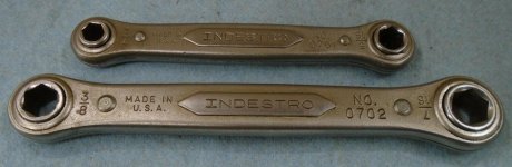

Kastar also manufactured them for Indestro / Duro, presumably to "fill a gap":
Indestro 702 3.8 x 7.16 ratcheting box wrench (LANG patent 2500835)(Ebay 153235897313 01).jpg Indestro 702 3.8 x 7.16 ratcheting box wrench (LANG patent 2500835)(Ebay 153235897313 04).jpg

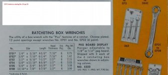

Which is a bit puzzling, as Indestro designed and manufactured their own version, shown below:
Indestro 0701 0702 0702 0704 0705 0708 SAE Ratcheting Box Wrench - 1972 Indestro catalog pp 35.jpg Indestro 0701 0702 ratcheting box wrench (patent )(ebay 254582191451 02).jpg
The Indestro model was available only in the flat style, not the angled-head version, and the metric sizes were not made available until Indestro's later years.

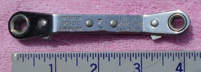

I found this S-K offset ratcheting wrench with the Lang patent numbers at a garage sale this morning. IMG_2589.jpegIMG_2594.jpeg
