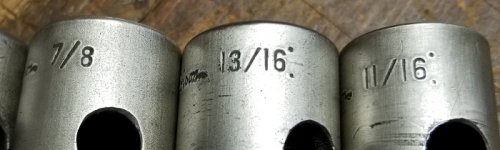

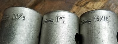

30,978
That colon mark after the size markings will be very familiar to Duro-Indestro collectors. It's a classic Duro-Indestro tell, seen on many Duro-Indestro sockets in this era. Here is a smattering of examples I pulled out of my Duro-Indestro drawer for reference. As you can see, regardless of the sub-branding (e.g., “-D-I-”, “CHROMIUM-VANADIUM,” or “- DURO - CHROME”), they all use that colon.

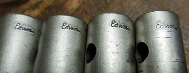

More shots of the logos on the sockets...
The ratchet body and the sockets are cadmium-plated, by the way, giving them a beautiful satin appearance.

You may note that Duro was known for fluted sockets in this era. That’s true, but they did make them unfluted as well, including their Select (carbon manganese) Steel lines.
In this 1940 catalog figure of set No. 9996M...
...only the smallest socket is fluted, and it’s a 9/16”. The smallest socket in this Edison set is 11/16”. That’s the next socket in the set in the 1940 catalog figure, and it is not fluted. None of the sockets from 11/16” on up are.
Here is a later Indestro version...
And here is a excerpt of the No. 1409 set from the 1940 Duro catalog, because it provides the best view yet of the box. It is without a doubt the same box as the Edison box.
Here is the duro version. Don't have original sockets so I keep some newer duro stuff in there.
