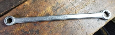

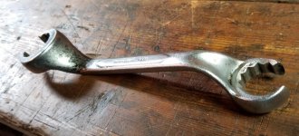

This is the first Duro-Chrome flare nut wrench I have ever seen in the wild. Honestly, I didn't even know they made them! It's a 383A (15/16" x 1-1/8")
Huh. I have afew Duro flare nuts but none with an offset. The size pairing seems to be unique as well. Nice find.

Oh, it sent me to the books for sure! I found them - on page 89! - of the 1940 catalog. They can also be found on page 59 of the 1951 catalog, where two new models were added: 379 (3/8 x 1/2) and 380 (7/16 x 11/16). This model number (383A) and size combination is not listed in either catalog.
Great job! Makes you wonder if yours was a special order?
I was thinking the same thing..... special order. I have a Williams obstruction wrench #2031 that is typically 25/32” x 7/8”. The wrench I have is stamped #2031 with the word “SPECIAL” also stamped on it. Its openings are 7/8” x 1 1/16”. I haven’t seen any Williams info showing that they ever made an obstruction wrench with a 1 1/16” opening.
Possibly.
Another possibility is that it appears in an intervening or subsequent catalog. I only have 1939, 1940, and 1951. It is chrome-plated, so not produced between 1942 and 1945.
Duro-Chrome very notably used suffixes for wrenches they added to their line when a sequential number was not available, usually when the wrench being added already shared an end with the next closest wrench. For example, in their long 15* pattern DBE line, a No. 2015 is a 7/8" x 3/4" wrench. A No. 2015A is a 7/8" x 13/16" wrench, advertised as being especially suitable for International Harvester Tractor F20 manifolds. And in most instances they don't even call out a specific use, it's just added without a footnote.
Note that my No. 383A shares an end (the 1-1/8" end) with a No. 383 (1-1/8" x 7/8"). Whether a certain customer or Duro-Chrome noted the need first, it does seem likely it had a specific application that required a 15/16" end, but I do believe it was one common enough to merit a model number.
If I had to guess, I'd guess it appears in a later catalog in the 50's.

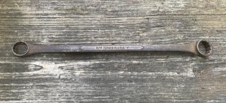

Here is a wartime Duro Circle DC marked 2016 DBE wrench that I found on eBay. These don’t come up very often.
-Don990FA6C8-C687-40B7-8C79-8A5DFA85227B.jpgDD6C52DC-EB87-4DB4-AC1C-7844F83B6514.jpg557BA248-925B-4392-A1C5-D3BDB4397755.jpg

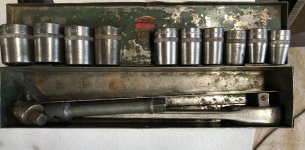

I bought this D-I 1/2” drive socket set last month. I was interested in adding to my few chrome plated D-I sockets and this set had four. My theory is that Duro had plenty of the plain steel sockets left over when the war ended and they chromed them and sold them off. I asked Indestro expert four.cycle about the ratchet and he told me that it was one that Indestro made for Montgomery Wards. I’ll eventually complete it with wartime D-I sockets and a wartime Duro Chrome ratchet. The last picture shows pretty much what it should look when complete.

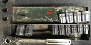

This morning I saw a Craftsman socket box at a sale. (Photo #1) Always curious, I opened it up to check the contents even though it is not an era I am interested in. Inside was a collection of Duro-Indestro older sockets, extensions, and a ratchet. (Photo #2)
None of the items were marked other than knurling and the socket sizes. The ratchet seems to match the photos of the Indestro 657 "Master" ratchet shown on Alloy Artifacts, less the markings. The ratchet works properly and has little wear.
The extensions are 4-1/2" and 9" long. The short one has no provisions for retaining sockets on either end, and the long one has blind holes where spring-loaded balls could be installed, but there is no sign this was ever done. The short extension has a diagonal knurl pattern on the band. The long extension has two knurls that do not match each other. One is kind of a checkerboard pattern and the other is the D-I dimpled-diamond. (Photos #3, #4, #5)
The sockets are of the Indestro pattern, 12-point sizes 1-1/16, 25/32 (3 each), 3/8 (1 each), and 11/32 (3 each). 8-point sizes 3/8 (1 each) and 5/16 (2 each). All the sockets are in excellent condition, with most of the original plating intact, and no rust. The markings all have the same pattern, a dot followed by the _/_ size, followed by another dot. The knurling is all the same. (Photos #6 & 7)
