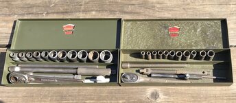

RagTopTA
Feb 26, 2015
1,892
Wichita Falls , Texas
Heres a Duro set I forgot I had. Found it sev years ago at an Estate sale in a rickety old garage.

Found a 1970s era Indestro Classic 1/4 & 3/8 Socket set today, #S6310. The good part is all the set's sockets are there and they and the box are in great shape. Unfortunately none of the drive tools were in the box. I spent a fruitless 45 minutes searching for them at the estate sale. After getting home and checking my stash, I have the 6272 Ratchet but not the 6073 Spinner or the 6230 2-5/8" extension. I've included my 2879 spinner until the correct one turns up.
29,774
^ are the sockets in that set "Select" (two plain bands) or "Super" (single knurled band)?
"Classic" was usually "Select". (The only place the word "Classic" appeared is on the label inside the box lid and in the catalog.)
(There were some "Classic" sets produced in which the sockets are stamped only with "Indestro" - (no "Select" or "Super", and on those sets you can get away with either on the drive accessories.)
That yellow-handled 2879 is a very difficult to find item - even the later white and clear-handled models are almost non-existent.
There are frequently 2873 spinner handles listed on Ebay - unfortunately sellers think they're made of platinum. Sometimes you can score one on the cheap.
The 6073, from what I've see, is a bit more difficult to find (at least on Ebay.)
You can probably find that oddball extension as part of some kind of "package deal" on Ebay - most likely mixed with some other odds and ends.
Nice set, btw. Box appears to be in cherry shape (at least on the inside.) :thumbup:
