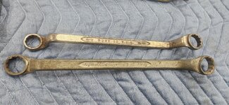

30,955
This one is the right size but I don’t know if it’s the style/finish.
'Ppreciate you looking. Same style (although I did make a mental note to ask 4.c 'bout them curious little X's on some of mine inside the panel near the size marking...), but looks to be black oxide or just dark steel. I will tag you if I get desperate. I could always strip the finish. But I am thinking I will run into one eventually. They are not uncommon.
Of course, you might have guessed I have duplicates of both of your missing wrenches. Let me know if you'd like Santa to deliver them to your stocking.
I suspect your stubby wrench is potentially not part of your kit. I don't have an extra full size 7/16"x3/8", however.
While I had the "dupes/trading fodder" box open, I pulled out the 1/2"-9/16" wrenches and am one-for-three on miniature x's at the ends of the recessed panels, but only on the one side.

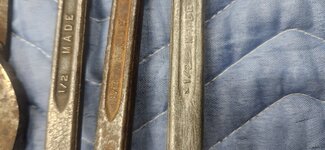

I suspect your stubby wrench is potentially not part if your kit. I don't have an extra full size 7/16"x3/8", however.
I think you're right. It will give me something to look for myself next year.
Thanks for checking! Weird, right? Had to signify something in the forging process, methinks. It's not branding. My 1/2 x 9/16 wrench has two, but the 15/16 x 1 wrench only has one, near the 15/16 marking.
