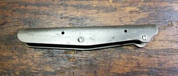

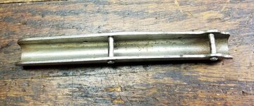

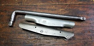

What seems odd to me is that this style, with the two pins and the holes for the extra detent ball on the bar to lock in, is much more sophisticated than the other style, which is just a sheet of pressed steel with the ends pinched, and yet the cruder pinched one is the one they patented (1744413 / Peterson / 1930).
They were making and showing them both in the 1935 catalog - this one shown with a bar made from square stock (No. 646) and the other (patented pinched type) for a bar from hex stock (No. 1306).
In the 1937 catalog, the only sheath they show is the patented pinched type, and it's used for round (No. 646) and hex (No. 1036) bars. Almost like they dropped the other type.
I have both types, but only one early Indestro 1/2-inch drive offset bar. (I had a second one, but I think it was part of a massive trade/swap/gifting session with @LesserSon a couple years ago.)

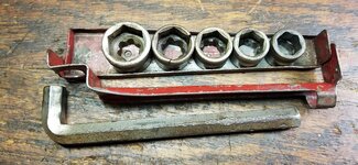

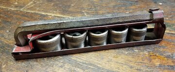

I plucked this one piece at a time out of a mess of stuff in an old toolbox at the flea this morning. Spotted a few tell-tale shallow sockets first, then the L-handle, more sockets, and eventually the holder. Marked No. 300 on the L-handle and the holder. I don't recall seeing a No. 300 set here on GJ before (search of thread on "300" returns nil), I don't see one on AA, I don't see it or the Indestro equivalent in the 1935 cats on IA/ITCL, and I can't find any trade mag ads for it on Google Books. The patent number on the L-handle is for the 1931 Petersen/McNaught holder, as expected, but I have never seen one quite like this, and the one shown in the patent diagram and the examples we typically see have a slightly different mechanism at the long end, some little extra holding tabs on top, and a provision for a ratchet. This is also a rather small set. Hoping 4.c knows more.

I have an Indestro set with that patent number on the holder. The holder and knurling on the sockets is different and the set has a ratchet.
Yes, they're fairly common. That's what I was referring to here...
There are a couple other variations, too. But I don't recall seeing one like the one I just found before, here or AA or anywhere else, or with the model No. 300. Hoping 4.c knows more.
29,971
@Leviton - your odd ratchet is a New Britain / None Better
@d42jeep - that pencil-thin skinny-handled number I think is from somewhere between post-WWII and about 1960 or so.
@Private Lugnutz - you got me. I seem to recall that patent 1788535 applied to more than one design of holder, and I can't think at the moment of where the documentation is, if it exists at all.
After just re-reading all this (and checking previous posts with that patent number):
YES, several different holder designs were manufactured that were all "covered" by 1788535.
post in this thread about 1788535

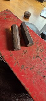

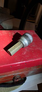

I recently purchased a whole lot of socket boxes off sleezebay. One box contained some sockets (pleasant surprise as I was just buying an empty box lot). Amongst the sockets (JH Williams, Fleet, Indestro) are a few star branded Indestro hex drives. Along with these was this 2" drive plug. It's not a standard sized drive plug or even standard looking. Its possible it was machined from a larger hex drive handle. Was curious if anyone had seen a drive plug like this?1000019293.jpg1000019294.jpg
