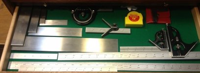

Here is a place to start;
Clockwise from bottom right corner:
#13C 6" Double Square. Note blade is so shiny it reflects direct light. Slightly embarrassed by this, I special ordered a Satin Chrome blade for this a few years back (after I took this picture).
#13A 4" Double Square. This dates around WW2 and is not pristine, but pretty darned nice. I replaced its worn blade with a new satin chrome version (did I mention I like satin chrome?). I checked this against my master squares. Its not perfect and it changes as you move the blade- probably from dust on the blade and such- but it's SO close it almost isn't worth talking about.
#453 Die-makers Square. The blade can be angled with the second screw in the stock. It doesn't lean quite enough for it to be useful for marking hand cut dovetails, but the angle can be eyeballed and the squares lines marked quite effectively. This thing is a super accurate jewel, that's handier than one might think. Had i to do it all over again, I would probably just buy the #14 without the angle adjustment. Also, I have the whole set with the different blades and never use them.
H33J with 6" scale. This is the hardened head from the junior combination square set. This one is easily 60 years old. Again, scale replaced with a new satin chrome model
#70A and B scribers. These have carbide blades. The HSS blade would be easier to sharpen or reshape into knives that would be helpful for woodwork. Recommend the bigger B model (3/8" barrel v. 1/4" on 70A).
#236 Combination Depth and Angle Gage. This is a handy little devil that gets lots of use in my shop. You can still see some traces of the original salt acid bluing that makes the psychedelic finish. I touched up the black oxide with Brownell's Oxpho blue creme (all adjuster knobs). It has an interchangeable 6" scale and a rod. Very handy for woodwork.
Bottom Left Corner:
#47 Improved Bevel - not a woodworking tool, because its so thin, but can be useful for that reason sometimes.
C33J Center head from the Junior Combination Set. This accepts the thin blades from the 4" double square.
Top left corner: Dessicant pack- always a good idea
#49 Combination Bevel. Haven't found a ton of use for this yet. Ebay seller I bought it from didn't know what it was and i got it for less than $10. (this has typically been my experience with all of these tools).
Middle top: Spare 4" combination rule.
New, these tools would be pretty expensive. I bought the satin chrome scales as cosmetic seconds on ebay. Each one was probably $10-15. Its always a good idea to check the ends of your rulers/scales. Sometimes they are long or short. These were all fine. I've never encountered a problem with ruler, but I only buy/use decent quality tools.
As woodworking tools or general hobby layout tools, this is a good set to consider. Its nice to have smaller tools in a wood shop to check machines, or edges etc. And Starrett tools are made so well, even 50 or 75 years old, these still have the accuracy you need. People really took pride in their work back then- both the manufacturer and the customers.
Now-a-days, many pro machinists don't do hand layouts. They machine to NC tapes. So there are a lot of these tools around for cheap. That won't last however. These tools will disappear, finding their way to landfills after Grandpa dies. People just don't know what they are or can't imagine how they could be useful. IMHO, worth shopping for some of this, cleaning them up as I have, and using and appreciating great USA made stuff.

Here's some of what's left of my work tools. I took a lot of them home to use in my shop there. Here's a combination of Starrett, Mitutoyo, Browne and Sharpe, Lufkin, Anton, Interapid a few Chinese and a bunch of stuff I made when I was younger.
In general I prefer Starrett's hand tools for the most part. I did buy the Mitutoyo step mic. because I like the feel better than the Starrett. You can't beat Interapid/ Browne and Sharpe indicators though.
