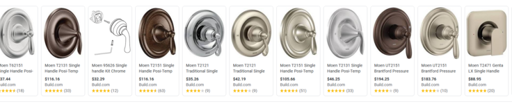

But what handle goes with what?
Various handle styles and colors. You match have to match the handle type to the valve type:
(I didn't verify all these fit the valve I mentioned, but you get the idea)
Moen offers dual controls if that's your preference too. But the selections of handle type are more limited.
