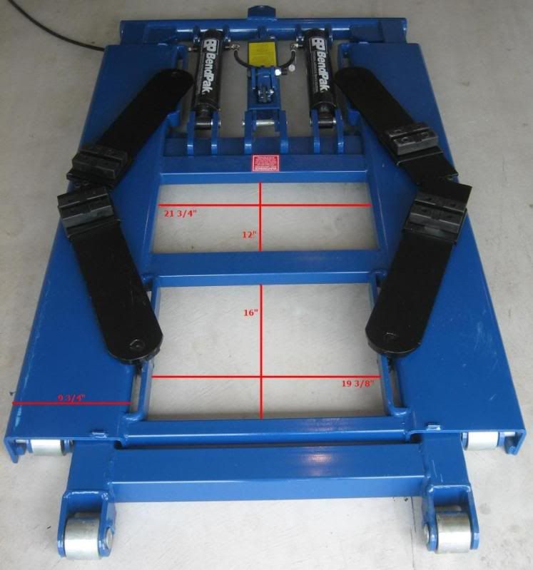

Has anyone got a BendPack MD6 Mid-Rise Sicssor lift, and that wouldn't mind taking some dims for me.
I was going to buy one but Funds have tightened up near the end of my Garage build and I would like to just make one. I can build it in CAD first so if anyone else wants a free copy once I'm done, perhaps I could post it here somewhere.... with a Disclaimer of course...
Thanks

I have one.. hit me up w/ any questions.
Floorplan: http://www.bendpak.com/files/260_1491341271.pdf
Mine:

Local Price for a MD6 is $2600.....
Pump and motor unit is $400, Cylinders say $400 tops, Hyd Pipes free from Work, Turning and welding I will do so that's free just the price of the steel say another $400 (suspect Less). So should be able to save at least $1400, and that will buy me a Compressor I need... So well worth the effort...
Princess Auto sells the Pumps and Cylinders....
Plus I have a Neighbour that wants one, and I said If I double up on all the parts I may be able to get some discount on some of the Stuff...

Now have all the dimensions i need thanks to a Good guy and all round helpful chap. Have done alittle modifing as the Cylinders I can get that are made for this kind of work are slightly different in stroke and overall lenght, but still works the same............
If anyone wants the CAD drawings just email me and I'll be happy to give them away, with a Disclaimer of course....
