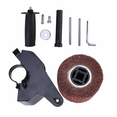

side grinder to burnishing tool adapters
toplessHO
Oct 20, 2014
14,146
central florida
bought one of these and shame on me didnt know that not everyone in the world has a side grinder that uses 5/8-11 threads
Is there anyone out there that makes the arbor extension for a 5/8 inch thread?
I would rather find the right one and send this back vs drilling and tapping

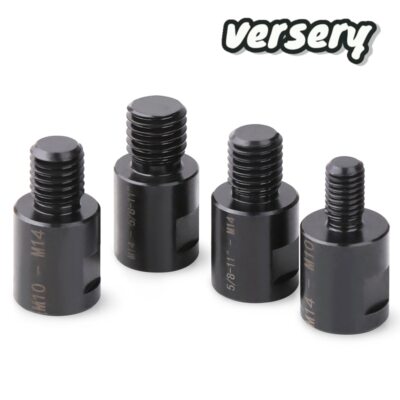

Do you have a buddy with a lathe? 5/8" is larger than M14 but there's probably not enough meat to bore & retap. I'd bore out that attachment, press in a sleeve the tap to 5/8"
But if you think adding an adapter extension should be fine for your needs, how about something like these?

this one is actually 10mm so if the proper arbor in 5/8 inch isnt available, I may need to get an M14 one and use as short of an adapter as I can find. This shaft is .750 so not a good plan to thread to .625.

bought the M14 adapter,sending back the 10MM one.
I tried an M14 to 5/8" adapter but it made the assembly too long,
so I drilled the M14 out and tapped it to 5/8"
It works like a charm for what I needed it for,cleaning up rough sawn cedar trim
