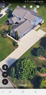

26ft from door out to edge of concrete. Occasionally drop a tire off when backing out. Its a good thing we don't have a wall right there. Also glad there is room for snow
