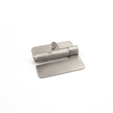

Id like to put a screen door on the side man door to provide some air flow. I have nice wooden one that i have planed down to fit perfectly. I had planned to use some lift off style flag hinges. The problem is im an idiot and that wont work. I cant life the door at all when open since its about 1/16 away from the bottom of the soffit/gutter. I need a way to have hinges that just pop off like some of the fancy cabinet hinges do i guess wiht the little quick release button. Do they make anything like that?
Google for quick release hinges. These look like they would work for you.
