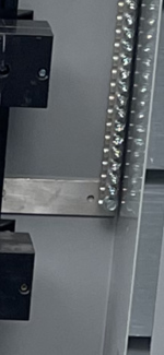

First off I want say thanks to all who responded to my first post asking about the proper wire setup.
Also I’m not an electrician, I was a general contractor for 20 plus years and trying to do a clean and competent install.
I pulled the wire in, and all went well, the most difficult part was the back to back LB’s through the garage wall. The issue I’m having is completely unexpected. I have contacted Siemens support to see if they have an option to complete this installation. The pictures show how I terminated the neutral using the manufacturer approved lug kit for the 4/0 neutral, torqued to spec and I thought, good to go. I then went to check the fit of the dead front and it contacts the neutral lug and holds the dead front out a 1/4” not allowing it to sit flush with the breakers. The bar on the right side of the panel sits on the back of the enclosure but it’s so tight to the side there’s no way to install the lug there.
I have a few ideas about how to resolve this and would like to see if anyone has come across this or has any ideas I haven’t thought of. It seems strange that lugs would be listed that don’t work anywhere. Even if I downsized the neutral the smaller lug kit still doesn’t clear.
Here’s my thoughts,
1) Attach a small Siemens bar on the left side drilled and tapped through the bonding strap identical to factory install of the bar on the right. And add the lug to that.
2) use a Siemens collar strap sized for 4/0, in the same location, that may move it back enough to clear the cover, it’ll be close.
3) there is a factory spot below the bottom breaker to add a ground bar, I could install that and add the lug and also add a jumper wire from there to one of the factory bars. The largest I could install is 4 awg for the jumper since the lugs don’t work lol.
Are any those options viable? Any other ideas?
I haven’t heard back from Siemens yet, I’ll update when I do. Thanks in advance for any replies.

Move the adapter to the bar on the other side. It's too small to tell on the phone, but it looks to me like the bar on the left has stand offs to allow the conductors from the meter side to pass through. The other bar appears to be mounted to the back of the can.

The lugs are wider than the bars and the one on the right is so tight to the side, they will not install on that bar.

The two pin style is not listed for that panel.
I suggest you locate the existing lug to the other side as sparky71 suggested. You will need to drill and tap 3 holes to move the bar inward. Can probably move it just enough to hide the old holes. May be easier to flip the bar 180 so old holes don't crowd new one.

Thanks, I think it just has 2 attachments, one through the bonding strap and one near the top of the bar into the enclosure. I have some longer matching slotted hex 10-32’s coming with some serrated flange nuts. I could drill and tap, install, and throw a nut on the back for piece of mind. It would be the least alteration of the design and only use the approved accessory. Just some extra labor pulling enough wire to reach the other side.
EDIT: There is a hole in the bonding strap in about the right position, does it matter if the enclosure is threaded but not the strap. I could mount it over that hole if it’s allowable to mount that way.

Use the same method as the existing.
Makes sense, if I don’t hear back from Siemens by the weekend that’s the way I’ll do it.

Update on this issue.
Siemens got back to me and this is what they said:
“Engineering has reviewed and agrees that this is an issue that needs to be re-worked. For a short term solution, our product manager would like to ship you out a new lug and mounting screw so that we can resolve this issue for you immediately while we work on a redesign to resolve the issue”
Could be a custom lug that mounts to the bar but more on the side maybe, that clears the dead front, or possibly a lug to mount through the bonding strap at the back of the enclosure.
I’ll post a picture when I receive the lug.

Update: The lug kits from Siemens support have arrived. They look to be custom made and have a cmc stamp on the back. They sent me 5 of them and I installed them at the bottom of each neutral bar. Passed inspection this week and am approved for service.

Yes, very impressed, once I called and they verified the issue, they got to a solution. I’m surprised it hadn’t come up prior, but with the line side solar input there’s probably a small market for this panel and folks were likely just coming up with their own custom solutions. Or just living with a dead front that doesn’t fully seat.
