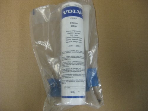

My favorite... :rocker:
*Volvo truck 1161231 Sealing Agent Silicone
