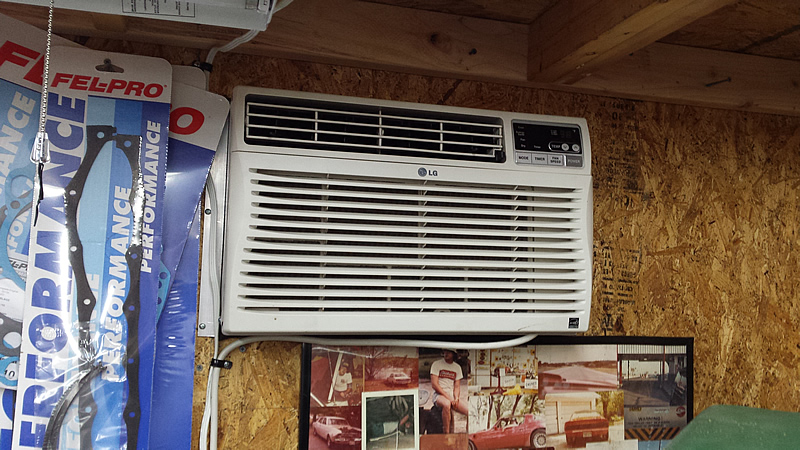

My experience with the bitty window units is that the 8000 BTU LG is the better of the pack. The 5000s are hit or miss, have tossed more than a couple. I have an 8K LG in the shop cooling the 288 sq/ft work room and it does well, throws air a good 20'. It's not loud and it's going on it's 3rd year in service.
The Frigidaire units are the ones I have had the worst luck with, just FYI.
