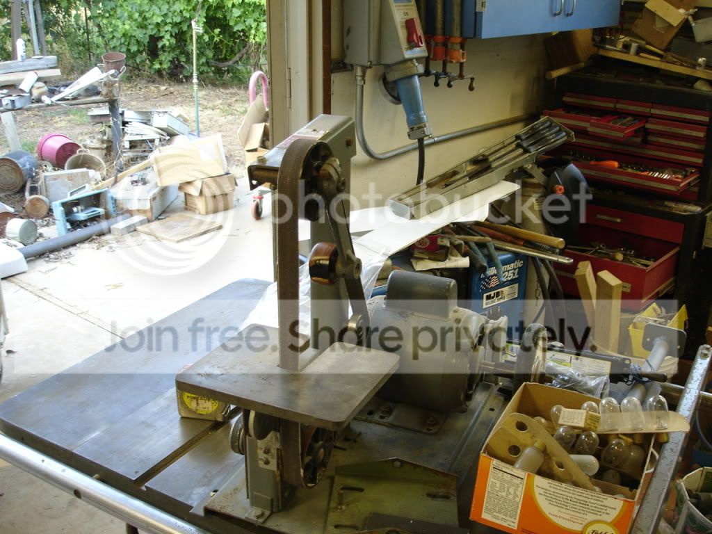

You can always look on eBay for pin & sleeve devices, I use Hubbell IEC style P&S for my welder and they are a quality product, don't care for the European competitive products although they interchange between the same ampere & voltage rating. but fleabay is not as cheap as it once was.
The photo below shows a 60A 250V single phase pin & sleeve in the background.
HP ratings for Hubbell pin and sleeve devices.
