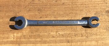

Last summer I bought a new metric set of SK flare nuts wrenches. I've really loved the SK products I've bought recently so I wanted to give them a try. We all know flare nut wrenches are something not to cheap out on so I wanted to see how SK's are these days.
I must say that, so far, I've been super impressed with the quality. The finish is nuts and I've had a fuel rail feed connection that was together for 20 years that was VERY tight. It was a 14mm and 18mm. I got the connection loose and the wrenches seemed to mark the corners of the flare nut pretty good. The fit of the 14mm seemed like it could have been a little tighter.
I was curious if someone with some new Snap-On flare nut wrenches could compare some measurements with me to see the tolerance difference. For a company like SK there isn't really an excuse not to have a tighter tolerance if they wanted to. Maybe they are manufactured to their specs, maybe something is off in manufacturing. Who knows.
The ONLY OCD gripe I've got with these wrenches is that the roll marks on the 9-11 wrench are reversed from the other ones. Meaning the the offsets do not line up if you line up the roll marks in your drawer.
14mm equates to .551". My 14mm measures .559". That's an 8-thousanths clearance. Couldn't it be a bit tighter than that?
10mm equates to .394". My 10mm measures .401". That's a 7-thousanths clearance. A little better.
18mm equates to .7087" My 18mm measures .7240". Over 15-thousanths clearance? Seems like A LOT. Maybe that clearance is some sort of standard when it comes to making the fasteners but it still seems like a lot.
Can anyone mic those sizes in Snap-On to see how they compare?

The clearance is not the only factor, they can flex too. I used to own some of those flare nut rounders that craftsman makes, now I own Snap On. It also depends on where you live, I live in the rust belt, if I lived in Arizona, Harbor Freight would probably work just fine.

I sure wouldn't want a tighter clearance the 8 thou. I'll gladly check my SOs in the morning for you though. But now that you have those values you can double check your SK from time to time to check for spread.

And what are you using to make your measurements? Dial calipers or a micrometer?
And did you mic (with a micrometer) the 14mm fitting?

The 14mm flare nut in question measures .5513" 3-tenths over what it mathematically converts to. The wrench has an 8-thousanths clearance on it. It doesn't sound like much, but the wrench rocks back and forth on that fastener a pretty good amount.
I know that spreading is obviously the other huge, and probably more prominent, issue with cheap flare nut wrenches. I would like to think that SK's metallurgy is on par with any of the tool truck brands and will not spread like a cheaper brand. I put a lot of torque at this union to break it lose and didn't feel the slightest bit of spread.

I took the measurements with the internal measuring part of a set of calipers, locked it, rechecked the fitment then mic'd that with a micrometer. I feel it's within half a thousandth this way. I'm no machinist...

Snap On Flare nut wrenches, warranted for brand new ones in 2012 or 2013 shortly after I purchased them brand new. My first two sets (metric and SAE) had 11 out of 12 broached severely off center out of the box. Talk about just buying Snap On so you won't have problems, right?
9MM- .3650
10MM- .4010
11MM- .4460
12MM- .4790
13MM- .5170
14MM- .5590
15MM- .6040
16MM- .6385
17MM- .6790
18MM- .7205
19MM- .7550
21MM- .8370
Dead nuts on except for the 18MM, but still pretty close

Checked mine too:
10MM .4010 (well used)
14MM .5585 (well used)
18MM .7155 (brand new never seen a bolt)

I went through the rest of my set and they're all pretty much dead on your measurements Loscaldazar. For the large 18mm size, we are less than the thickness of a sheet of paper so I don't think that would make much of a difference practically.
I don't have a way to check hardness levels but must assume SK's alloy is of premium quality. I suppose I'll keep these to see how the perform and if I ever have any spreading as time goes. I only have the metric set so far.
I put a huge amount of torque on the fuel line union (14mm and 19mm) and there are some marks right at the points of the fastener but otherwise there is no peened over metal around the corners like if it were rounding it.

In metric Snap-on only had 0.002-4 inch clearance. I was always having to pound them on which I didn’t like. Proto and Mac gave me 0.006-8 clearance which I liked. Mac, Snap-on, and Proto finished about the same in the Torque Test Channel video, with the Snap-on getting some of its points for being what I think is too tight, so your mileage may vary, but I don’t think you will be stuck with a bad tool with any of those. The cost varies considerably though.
