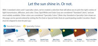

I used some of those Poly Carb panels over an outside work area a couple of years ago
I got them through a local lumberyard, but I think Lowes and HD either carry them or something similar
They come in different colors and there are different levels of how much light makes it through. For example, I used the 'solar grey' which is supposed to let about 35% of the light through, but it was still too bright/hot and I ended up buying some shade cloth to put over it
No matter what color - all their panels are supposed to have 99.9% UV protection
Warranty - "Limited lifetime warranty, including 10-years for damage due to hail"
I am happy with them
