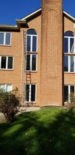

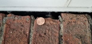

Yep, just dealt with this at a customer's house last week. FlashMate is an amazing product, but it's only a temp solution for those penny sized gaps. Every window in that house had at least 1/4" gap somewhere around the perimeter, and those tall windows had at least 5/8" at the tops. I think the brick has moved, and probably the framing, and certainly the windows...Probably not enough or improper fastening. No issues with the skylights in the house though. :dunno: LOL
Somebody not add or use brick ties ? Looks like the entire veneer is pulling away.
I wondered the same thing... It feels dead solid, but no doubt something is moving. Overall I'm not impressed with the brickwork overall...Sometimes inexpensive labor can be eager and willing to bust ***, but not knowledgeable or well trained. This house was built in the mid 1990s when that was very common Also not impressed with the cedar siding being caulked under each row and especially caulked at the starter row and drip cap...Sure you wanna keep water out, but you also don't wanna keep it in. I wonder if the builder had the cheapest subs or maybe non that were dedicated to him for some other reason. New builders and those who don't pay on time often have to find a sub they never worked with before, or use what's available and not booked up.
Just like with skylights, problems happen with improper installation.
