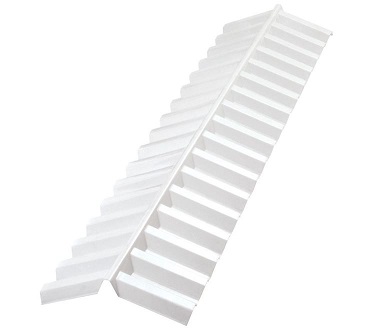

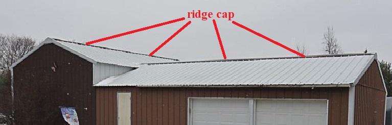

Each building is roughly 30x40 feet, the roof is /\ shaped and the skylights run along the peak, the skylights look to be upside down "L" shaped to fit the peak.
Edit: Ridge Cap - see photos below and in further posts down the thread.

Edit #2: This is not the exact one on the barn but this is what the skylights look like. Gives you an idea.

I'd confirm that it is not a clear ridge vent. How far does the clear section extend down from the ridge?
https://www.menards.com/main/buildi...rbonate-ridge-cap/1594406/p-1444424086117.htm

I'm of the belief that what is being referred to as "skylights" is in fact clear center ridge cap.
Scroll down to the 5th post @ Pole barn lite panels
:beer:
W
WIHD
Feb 12, 2019
163
WI
:beer:
Thanks! I think you nailed it!

I did find a pic online of the home, here are the barns below.

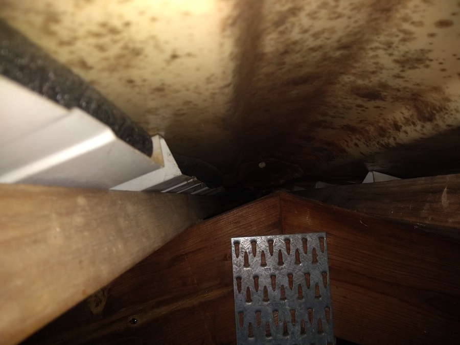

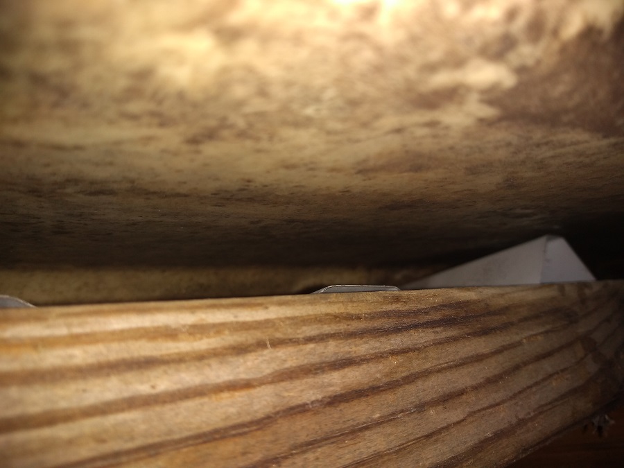

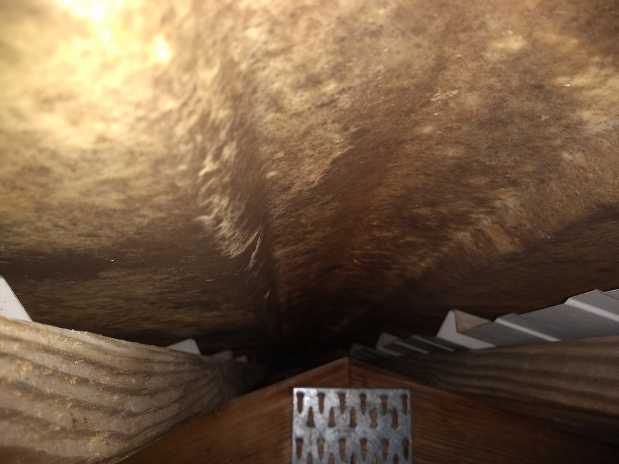

Some pics, there's snow on top so not a lot of light coming thru. This is only one of the barns, the other is pretty high, no way to get up there w/out a bigger ladder (was only at the house for an hour yesterday, bought a laddder to look).
These barns look mostly used for cold storage (outdoor equip) but I'd like to drop in concrete and put in more power/lights etc.
Looks like someone tried to stuff in some foam in this pic, though there wasn't any damp anywhere I was feeling around:

I see foam seals in the pics??
Are these foam seals the wrong type?
from post above w/ the photo:
"Looks like someone tried to stuff in some foam in this pic, though there wasn't any damp anywhere I was feeling around:"
that was an attempt by someone to stick pieces of foam in afterwards.

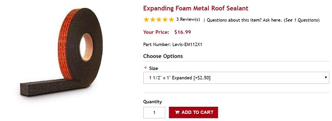

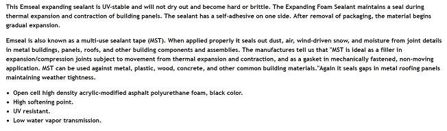

ran across this thread: https://www.hansenpolebuildings.com/2012/05/ridge-caps/
which led me to this product. Anyone ever use this? looks like this would expand to fill the gaps and I wouldn't have to pull the ridge caps to install. Could put in gaps between the ribs, then let it expand etc...
https://www.roofthings.com/expanding-foam-metal-roof-sealant.html
Available compressed thicknesses:
3/32″ (10mm) up to 2″ (50mm)
Equivalent expanded thickness:
3/8″ (10mm) up to 4″ (100mm)
Here's the actual company, can buy these cheaper at different sites (than Amazon for example)
https://www.emseal.com/specialty-gaskets-tapes/product/ast-hi-acrylic-mst-metal-roof-metal-building-sealant/
These are also referenced on Hansens site.
https://www.amazon.com/Emseal-AST-Acrylic-Sealant-Tape/dp/B00H1CEGDW

Followup....ran across my own old post years later so thought I'd post a followup.
I pulled the original translucent ridgecap as it was old/crispy/failing and replaced with 10 foot sections of standard 29gauge steel ridge cap.
I put VersaVent on the underside of each 10 foot section for wind/rain/bugs, it did a spectacular job and was ridiculously easy to apply. Would use it again.
https://www.atlasfasteners.com/product/versavent-ridge-vent/
AST tape in prior post....not the solution. I bought some for a diff project and it was heavy foamish, not for a ridge vent. Also the adhesive was poor on the backside unlike the VersaVent. Thanks
