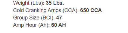

SLA battery CCA vs. Ah ratings, DOES NOT COMPUTE....
TT_Vert
Mar 9, 2018
1,436
Wauconda, IL.
So I have this battery which is 650CCA yet shows 60Ah. From the conversions I've seen it should be CCA \ 7.25 or 89.6Ah but the battery label shows otherwise. I also looked an official AC Delco spec page and it also shows this as correct. The reason I'm even asking this is because a battery charger I am using want the Ah details for computing cell status.

CCA, or cold cranking amps, is how many amps the battery can deliver for 30 seconds at 0°F (-18°C) while maintaining at least 7.2V. It has nothing to do with the amp hour rating, regardless of the google search result formulas.

Thanks guys. It's strange how I find the exact same info on a conversion for CCA to Ah. What doesn't make sense is this.
The conductance battery tester I have can test two ways, both using values on the battery. One way fails, one passes due to this current vs. capacity calculation.
1. Enter CCA (650A) and it fails
2. Enter Ah on label (and it passes). When I enter the 60Ah rating it does calculate that to be 480CCA which is similar to the equation online.

That sort of tester isn't calculating either of those values (that is physically impossible for a device like that to do that). It just makes an estimate based on industry averages, centered around starter batteries. And it's going to make terrible assumptions when faced with an SLA unknown to it. Now if you had something like a Midtronics, with a stored profile based around your specific battery model, then "internal series resistance" or impedance testing can be of value. But as it is, unless you recorded the values of that battery when brand new, this doesn't mean all that much.
And even then, at 74% of charge, simply forget about using a tester like that. It's just not reliable down there! Charge that battery all the way to float before you even bother testing CCA.
And even then, at 74% of charge, simply forget about using a tester like that. It's just not reliable down there! Charge that battery all the way to float before you even bother testing CCA.Right,
Right, it's not calculating but computing using a formula which appears to be Ah x 8 to get CCA. So now my concern is how can I reliably use a tester which can generate different results based on different info on the SAME label? I load tested this battery and it tested marginal but still good in my opinion. However, the other day I did the same for another battery for a friend which I am fairly certain it had a weak cell but the load test also came back good so I lost trust in this method and went out and bought a well-regarded but cheap battery tester that quite a few people on youtube like and had a TON of good reviews on amazon (I know to take those with a grain of sale). And now I'm in this position where I'm not trusting this because of what occurred above.

You're not listening. There is NO generalized fixed relationship between CCA and AH (or between either of these values and ESR). Your tester is fooling you by implying that such a relation ship exists. In reality, it tests ONE value (and truthfully its none of the above) that has a good proprotionality with ESR (when the charge state is full, and the temperature is moderate). It then hallucinates a guess about those other values based on the one fact it does know. The problem with that is without knowing more about YOUR battery, those other values aren't meaningful. It's like guessing your car's speed based on the radio volume. A big name like Midtronics comes with profiles that list known values for major lines of batteries (and matching big prices).
I happen to own a similar ESR battery tester, and I also happen to like it. But I've tested enough batteries to know its limitations. First off, when I get a new battery I'll charge it up and test it immediately, then paint-pen the values I get on the top. A few years later, when I know it's charge state is >95% (because below that, it's completely untrustworthy), I can compare the CCA with my prior value. As a general rule for standard car starter battery testing, my tester will indicate 125% to 150% of the label CCA when new, and by the time it drops to 80% of the label CCA, that battery is toast.
But even with that, there is NO point in using a tester like this to compare against multiple battery parameters. Unless we're talking about deep cycle batteries, stick with the CCA and forget the AH values. The false relationship between these two that exists ONLY within the "mind" of these testers can only lead you astray.

Thanks for the info. I wasn't saying there is a direct correlation. I understand there cannot be due to many variables.
