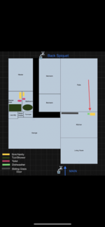

Can anyone help determine if water supply goes to kitchen 1st or water heater 1st by photos provided above? Also tell me what lines to isolate if you were trying to determine a leak coming from below kitchen sink but solely see water coming from outside on stucco nothing inside right at thIMG_6703.PNGIMG_6702.PNGIMG_6701.jpge foundation level (red arrow). Hours later, if at all water faintly appears in the middle below sliding glass door as well. 2nd picture is below kitchen sink. 3rd is what is under water heater. Thanks.

Usually the interior water shut-off is the best clue to the location of the main into the house. I have seen them inside vanities, near water heaters and anywhere else you can imagine. However, it looks to me like yours does come in under the kitchen sink (the tee'd line) and there is no shut-off there.

I agree and this has been crazy honestly think I have a record for amount of leaks here. I thought it was there at first because there was a leak and that one was the cause of water coming up through my marble floor right along the wall that divides kitchen and living room. So i repaired that and no more water there but still had a leak here I guess too. 3rd picture is when I noticed leak put some saw dust down to try and track it path. That wall is saturated btw at least a foot n half up from floor already tore it out and venting it out as we speak.
