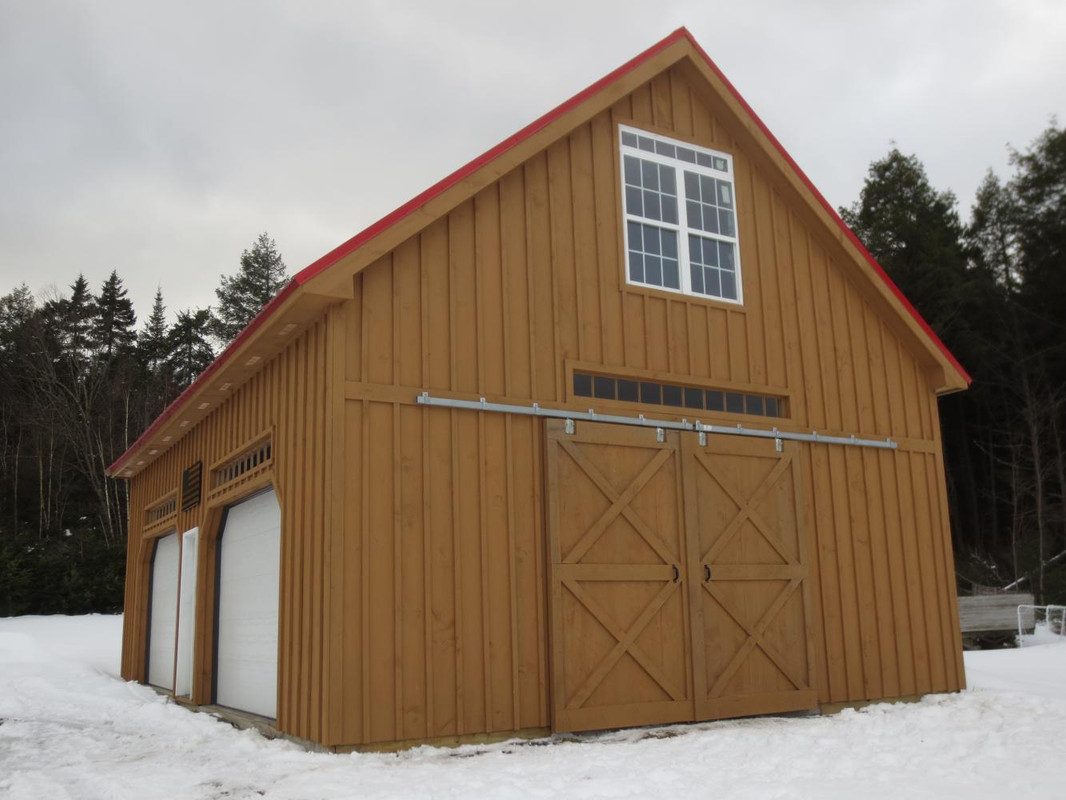

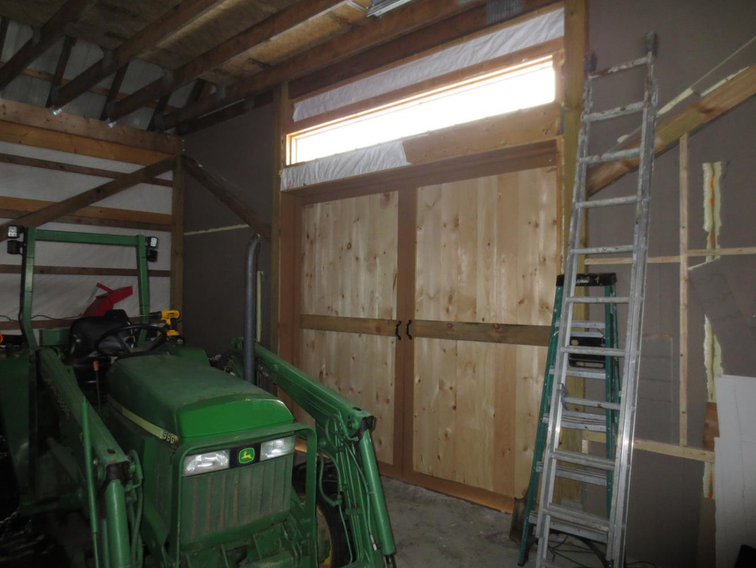

Mine have been in place for just about a year now. I used a bigger header than a 2x6 and my span is only 10'. I made doors out of pine and they are fairly heavy. Not sure how heavy your doors are but a 2x6 might be a little lite for that span. I used double 2x10's.
Not a big fan of my doors. They look great and are easy to use. But as kbs2244 said, they are just about impossible to get a seal on. If your pole building is going to be unheated maybe not a big deal. I am going to heat mine, and I am planning on adding an overhead door this summer.

I am indeed going to add an overhead door this summer. Here's the thing. The hardware and metal track for my door cost $250 I think? The T&G pine came out to about $400. Screws, handles, etc. let's just say about $700 for the sliding doors....and they are not insulated. I can get an insulated 10x10 overhead door for that same space for about $1200 installed and high lifted. So, $500 more....but since I am heating my space, it will more than pay for itself in heating bills. Wish I had just done the overhead doors to begin with. But I was trying to save money, and now it's only costing me more having realize my mistake.
I am not going to remove the sliders. I'll leave them up and just install the overhead door behind it, so I will still at least preserve the aesthetic appeal of the sliders.

If heat is not an issue then sliders will be fine. If you install some kind of a pre-bent metal cover for the track you'll be all set from above. If you make your doors wide enough that they overlap each side of your opening by 8 to 12" or so you'll be all set from the sides. If you're doing double doors like mine the only place you might get some wind blown rain coming through is where they meet. But there is hardware that will pull both doors tight together.
I think you'll be good!
