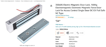

  3. Electronic 12 V magnetic lock system system that's used on commercial buildings for remote entry control. like this one. It would be accessed through a number keypad, or through an override switch inside the secure part of the house:

I work for a large lock company (ASSA ABLOY), and suggest you not use a direct pull mag lock as illustrated above. If you are determined on using a mag lock, use a shear type mag lock where the armature has small (anti) shear pins
