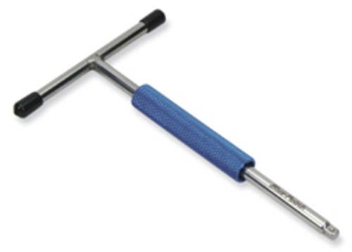

Those are sliding T handles, which I'd like to make dual purpose, also as a spinning T bar (when a rotating extension is added).
Here's a spinning T:
Here's a spinning extension:
If you try spinning a sliding T without a detent, it tends to slide to one side, and stop spinning or hit something, whichever comes first.

This works...
A bit more compact than the other. I slipped a 3/8" drive x 1/2" ID x 2-1/2" long socket over a 1/4" x 3" extension and put a 5/16" spring clip in front of it, then cut a thin strip of electrical tape to wrap in front of the spring clip (that keeps the socket from touching the tape, and the clip from being pulled off—edit: actually it doesn't, so I tried 3 spring clips instead, and this seems to hold). Also wrapped sports tape around the socket for a grip. Maybe I could do something more precise with some 5/16" bearings, but this is a pretty good fit for a lightweight handle.
The 1/4" sliding T doesn't really need a detent, because the bar isn't heavy enough to slide on its own. A swivel on that is best for following the bar around with one finger, from the middle position (no pun intended). Well it works okay extended too. :thefinger Both ways that is (I'm not that ambidextrous though). What else could I say? It looks like a finger ratchet too (and at least I wasn't the one who jumped off a teeterboard with someone else in mid air)! Never mind the flying fish...
