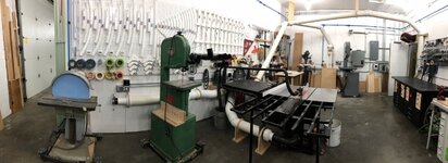

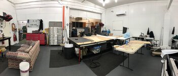

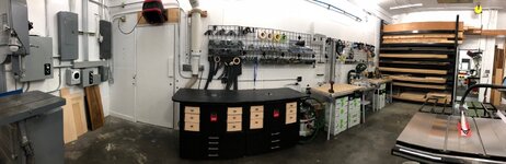

I thought I’d start a thread on the stuff I make in and for my shop similar to what others have on here. I have a custom auto upholstery shop with some fun tools.
Some recent shop photos:
Bay 1/2:
Woodshop:
Bay 5/6 (Upholstery bay):
Metal fab room:
Since these photos were taken the sofa was moved to make room for a large digitizing tablet.
Thanks for checking my projects out!

What are the white pieces hanging on the wall in this pic? Well organized whatever they are!
They are router templates, used to make shapes, rather quickly.
