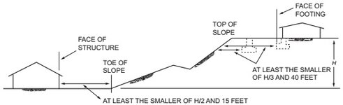

Planning to build a 960sqft garage in MN. Sent my plans to the city waiting approval, but now I found a code I that'll likely kill the whole thing. I was planning to build on the back edge of my yard that drops down to a valley 40ft below. Now I find this code that talks about setbacks to hillsides greater than 1/3. A few feet behind the back corner my hillside slopes to 29 degree (1.6/3). Am I screwed? I don't think I have room to move it 12ft forward. I read retaining walls can be built, but it sounds like only at the toe of the slope.

Here's the section that has me believing I can't build on the edge. I still feel like the inspector has it wrong.
R403.1.7 Footings on or adjacent to slopes.​
The placement of buildings and structures on or adjacent to slopes steeper than one unit vertical in three units horizontal (33.3-percent slope) shall conform to Sections R403.1.7.1 through R403.1.7.4.
Figure R403.1.7.1
R403.1.7.2 Footing setback from descending slope surfaces.​
Footings on or adjacent to slope surfaces shall be founded in material with an embedment and setback from the slope surface sufficient to provide vertical and lateral support for the footing without detrimental settlement. Except as provided for in Section R403.1.7.4 and Figure R403.1.7.1, the following setback is deemed adequate to meet the criteria.
My reading of the code is that you need to engineer your foundation for the specific conditions -or- follow the generic set backs provided in the code. It might be a little pricey to get engineered drawings and your foundation may be more expensive to construct but the project may be doable.
That's how I'm reading it too. I was hoping to get the entire project done myself for under 30k, but it looks like I'll likely have to hire an engineer. Thanks
