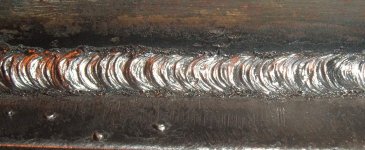

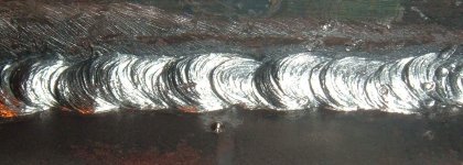

Now that is pretty !
How much of that is good technique/practice and how much of that is the quality of the welding machine ?
Here is a vert on some old rusty plate testing a machine. The one I show above was OH but these are verts, the second one is a cover type over a stringer and the first was old rod on old plate.
Now as to the machine or the person, here is my take. I cant really tell 2machines apart given they are the same type. I actually give the edge to my Linc AC/DC over the Max but its almost imperceptable and if a guy didnt run them side by side it would be hard to tell.
