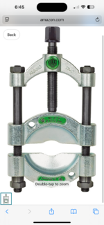

I think the problem with modifying the pullers you bought is that once the arms can get under the bearing, that part is now too small to grab the bearing. Maybe you could add a hose clamp or some other clamp around the arms to get them to grip? Maybe good enough to do a few anyhow.
It seems like the real solution is going to be a collet of some sort.
ChevyEFI
Sep 2, 2012
8,742
Phoenix, AZ
Another quick and dirty try:
A wrong-size bearing splitter with puller bolt holes at 12:00 and 06:00. Two allthread or bolts that thread in. Grind those bolts so they a: act as wedges under the outer race and b: clear the race while the larger bearing splitter is closed together.
The thing about bearing splitters is they sometimes have tondo the small work so you can finish off the large work.

This is an OTC 949-1/2; the edges taper out to very thin and the back is flat, I would be surprised if it didn't work. As far as the bearing that's recessed, maybe dry ice on the other end of the shaft and a miracle?
My el cheapo splitter was far from flat on the back side. So tossed it in the mill.
Ended up taking .1120 off of it. It’s flat now and works much better. Guess the cheap tool is now the quality of expensive one and actually works like it should now.
