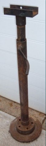

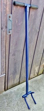

You can do many projects with very little. The first picture is what I usually use. Yesterday I repaired my pallet buster and used an 8 X 8" plate clamped on to the top of my third hand helper (third Picture). The pallet buster needed a complete overhaul as the 1" pipe pivot was crushed through very hard work at the hands of my wife.
I have never felt the need for something larger.

Above is one way to deal with a small welding table. I used adjustable stands to hold this arch for setup and welding. I also use vise stands for holding and fixturing if necessary. Your imagination is the limiting factor on setting up and holding for welding .
View media item 51083
For final welding one loop was clamped to the workbench and plumbed. The second loop was clamped to the first and squared with it and cross pieces welded in.
