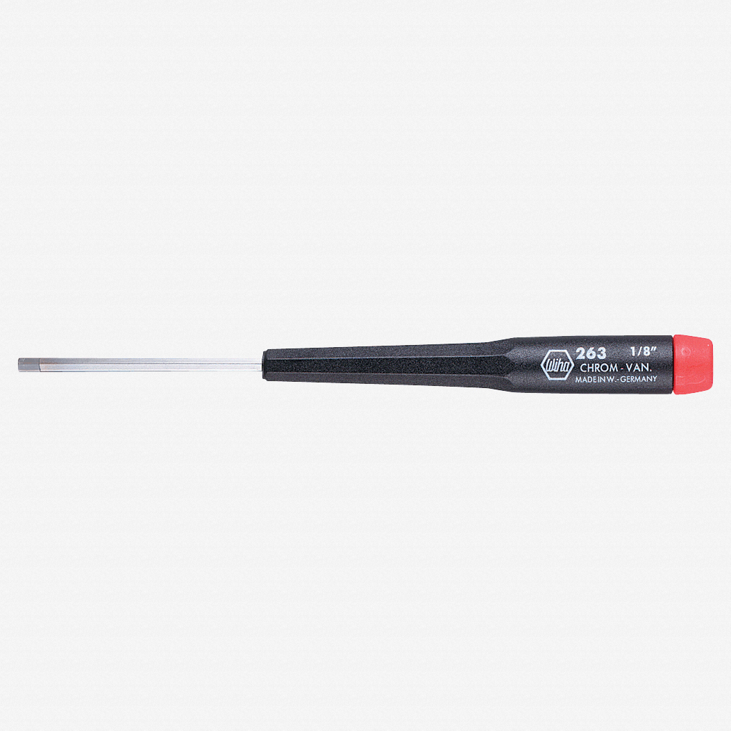

It comes down to personal preference, but I find Wera's precision screwdrivers superior to all others. The design of the handle has a hexagon hump which serves as a torque amplifier for thumb and forefinger.
By contract the Wiha driver's handle is slimmest where you need to apply the most torque.
Wera also has a wider rotating cap that tends to be more ergonomic. They also have a wide hexagon bolster that helps apply torque close to the shank.
The problem with Wera is that don't have the breadth of drivers that Wiha has. (like the Wiha master's technician set)
One other design choice Wera makes is to use a consistent handle size for all their precision screwdrivers. I think Vessel, Athlet (Elora, etc.), and Oplast (Hazet, Gedore, some Elora) use one handle size, too.
Wiha, Facom/USAG, old-style PB Swiss, and some others scale the handle size to blade length. Which is the better approach? Personal preference.
I've attached an sample of handle sizes of 2.5mm slotted screwdrivers. From left to right: USAG (Facom), Facom*, PB Swiss Swissgrip precision, Wiha, PB Swiss old-style ESD, Heyco (Felo)*, PB Swiss Swissgrip standard*, Elora (Athlet), Stahlwille (Witte), Hazet (Oplast), USAG (Facom), Vessel, Wera, PB Swiss Swissgrip standard*)
*No spinner cap.
*No spinner cap.
^^Thanks, excellent comparison image.
I don't understand why most of the others have the slimmest part of the handle where you need to apply the most torque with thumb and forefinger. (it's counter productive)
IMHO Wera is the only one that put some serious thought into effective/ergonomic handle design.
