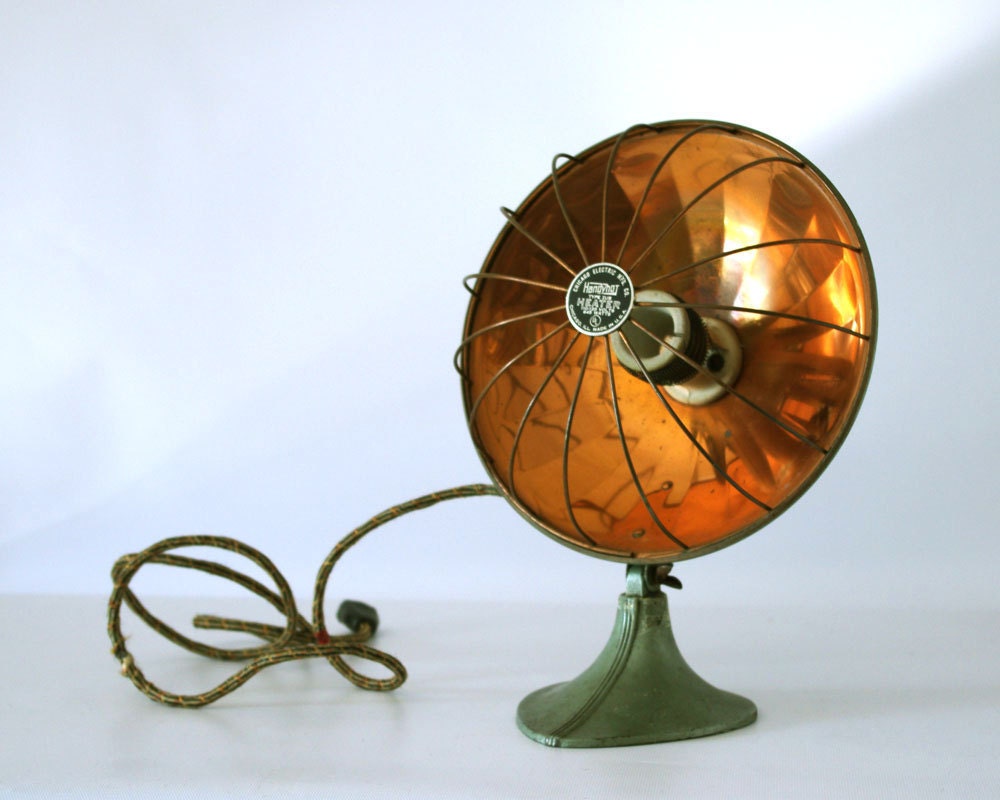

I actually have one of these in the attic. How effective are these?

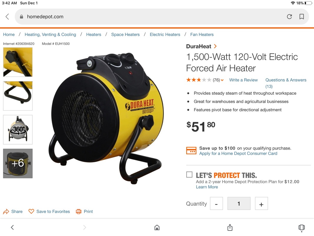

I agree with others that you don't have many options if a single 120V outlet is it. So several years back I lived in a 1200 ft^2 house that I heated with space heaters. Based on this I have a bit of experience with these things.
1. When it comes to heat transfer modeling, if they **** 1500 watts from the wall, they put 1500 watts of heat into the room. Don't let the different size/shape fool you. The are all 100% efficient. BUT, that doesn't mean they are the same.
2. Oil radiators are probably not the best unless you want to evenly heat everything. I used an oil-radiator kind in my bedroom because they are largely silent. The heat the room rather evenly and you don't "feel" when they click on or off as you do with a fan based heater. However, they are only good if are looking to provide whole room continuously. They take a while before they feel warm. They also stay warm after they turn off. For the most part the heat isn't directed.
3. Radiant heaters: These are the heat lamp kind. I haven't used them but I know some people like them. They are quiet and the heat is directed. If you had one area you wanted hotter than another this could help.
4. Various fan model. I had a number of these. Most were the smaller ones like these
https://www.amazon.com/dp/B000TKDQ5C/?tag=atomicindus08-20 (not a specific endorsement). They are compact but the fans are loud. Some have safety switches that shut off if knocked over. Other are taller and have a different type of fan
https://www.amazon.com/dp/B000TTV2QS/?tag=atomicindus08-20 (again not a specific endorsement). My taller ones seemed to wear out faster. You would get bearing squeal noise after a winter. However, they were significantly quieter until that failure happened. The small fan ones seem to last forever.
The fan type would be my first choice for this application. They start producing heat really quickly and since it's a flow of air you can stand next to it to feel warmer before the garage is up to temperature.
I would get one with a thermostat, even just a "hotter/colder" type. They aren't perfect but they do work. Most will have more than one heat setting.
