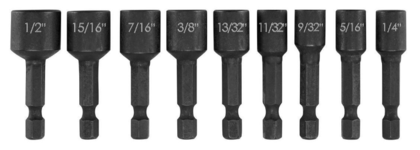

I think you want a set of nut setters. They're basically magnetic or non magnetic sockets with a 1/4 hex shaft for use in impact drivers. You can get SAE or Metric versions in all levels of quality and sizes. They also make them with longer shafts if you need reach. :beer:
Im just glad they include a 15/16 in the SAE set:
:lol:
:lol:
That's supposed to be a 15/32"
15/16" is not smaller than 1/2". I checked the specifications, and it does show it as 15/32" in spite of the engraving showing 15/16
So you might be wondering why they included 15/32" and it's because it's basically the same as 12mm. It is 11.91mm. So they probably are just using the same tooling as the 12mm and stamping it 15/16" even though it's really 15/32. #JustHarborFreightThings.
