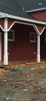

Hey, love your barn. It's above and beyond a New England style.
Question, can you provide details of the base cove or base board trim you used around the 4x4 post that supports the porch area of your barn? I like to do the same as my current 4x4 post, with the upper board & batten trim, look like chicken legs. Fat at the top and skinny legs so to speak.
I edited your photo to show to an arrow to what I'm pointing at.

If you wrap yours to get to about an 8x8, I think they'd look great. Then add some additional blocks like that at the base for an even more substantial look, plus giving some more protection

Thank you for the compliment! I was very lucky to get to build my dream shop.
My posts are 6x6 with the bottom wrapped in 2x10” with just a simple miter cut to fit and a 45 at the the top, about 20” tall. Simple, but effective.
You could build yours up as Mike suggested, then a simple detail like mine would really finish it off.

Ah, I see what was done. Only two pieces of 2x10’s on either side except the corner post which has two pieces facing the porch.
I stand corrected, I have 6x6 post also and not 4x4 posts.
