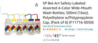

What I use; the polyethylene plastic used in them is pretty good quality:
I do note that the nozzles will dribble out solvent with air pressure changes after use, and that's got an easy remedy - when done, I turn the bottle upside down and squeeze until air exits the tube, thereby leaving only air in the tube when it's stored upright.
@LopezBart 's idea to use a pan as secondary containment is a good idea; I'll have to adopt that idea.
