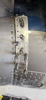

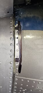

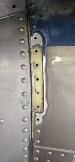

Had to make a quick repair. Got the engineering back today and knocked it out.

Back to your repair.... do rivets eventually stretch out a little and cause the holes to kinda egg out requiring replacement and it's basically maintenance?
Not a problem with rivets from what I know because the rivet alloy is harder aluminum than the metal skin. I could be wrong though. I think I this case it was that the rivets were improperly installed. I think whoever was bucking the tail must've pushed too hard which caused the manufacturered head of the rivet to be loose against the skin causing chafing.
