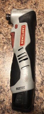

My 20+ year old Craftsman battery operated "hammer" tool sounds like it could be a candidate. Or a modern version if there's one out there in your case.
Internet photo of said Craftsman "hammer" tool:

Thank you for photos of the palm driver and the “hammer tool.” Going a step further, I would definitely like to drill pilot holes for the screws. My right angle drill attachment is ancient, huge, and warped. Right angle drills are tool big when you put the bit into them. Can anyone recommend a particular right angle attachment that they prefer and why?
