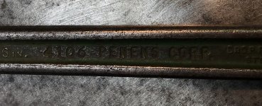

Unfortunately, only the main part. :sad:
STEELCRAFT Made in West Germany
So made between 1973 and 1989. :dunno:
Need GJs help to make this whole again !!

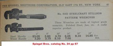

^ Post war. Private Lugnutz would be better able to give you the date range.
This is from an earlier catalog - most likely early-to-mid 1930s - so it predates your piece there, but these are the sizes they were offering at the time:
There's a dedicated "Steelcraft" thread HERE:
https://www.garagejournal.com/forum/showthread.php?t=478374

Thanks for the link !
The part I have is 5" long. So, with the top jaw, this must be the 6" model.

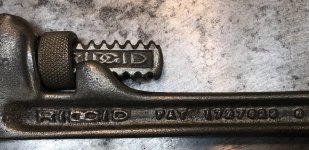

Here's some pics of my Ridgid 6" Pipe Wrench.
The transfer is hard to read in pic. #4, but it says:- "If this Housing ever Breaks or Distorts, we will replace it Free"
