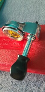

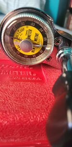

maybe it is the smallest...but maybe not? The dentist that installed a couple of implants into my lower jaw used a torque wrench. It was miniscule
Yeah i think you're right. 10 Newton-centimeters is less than 1 inch-lb.
