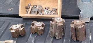

I picked this 4 head moulder up a few weeks ago. It needs more work than I originally anticipated. The top and bottom spindles have been chopped from 6" to 4.5" with a saw, as were the heads. The top head slide (gibbed way) was broken and welded back together. The inside head chip breaker is missing and the dust chute it mounts to is a bit of a mess.
But it's all there and runs.
I ordered a chunk of 1.75x36" 4140ph for the new spindles and a pile of bearings for all 4 spindles and 2 idlers.

This is the machine I got.It has rust but I think I can clean it up.I don't have the pieces that hold on the cutter heads do you if you do what do they look like? There are two pieces that are broken I have to have them welded.
The head retainers are just a thick washer with 4 pins
